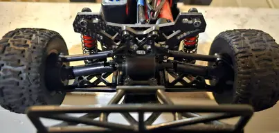

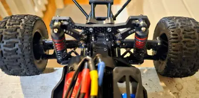

Do you happen to have any pics of how you added TT-O2 carbon shock towers?

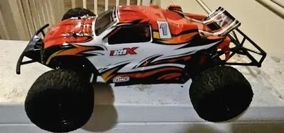

Yes, of course slick2500
Shock.protectors facing forward, i got the truck second hand so i don't know if they came backwards on the rear or were just backwards because someone flipped them? I used servo eyelets in the upper connecting rods to strengthen and provide less friction. Stock shox, just painted the shock bodies, added tamiya O-rings, and O-ring shock grease to prevent leaks and less friction. I love how it handles now, but I am currently working on adding Sway Bars. Completely ridiculous work done on a 1/18 plastic truck with butter diffs, but im cray cray that way! 😅
I had 65mm shox on it and was using the many shox mount positions available with the tt02s shox mount, but needed the 65's for another project....my half dozen completely modified WLtoys a9x9 trucks/buggies. All are 3s and have C.F. chassis and mods like servo reversed to the other side of the car to allow room for full length LiPos. They are pretty much anything but XK anymore.
