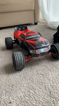

So UPDATE she’s almost done but is far enough along to drive i will add some pics
- shock towers still not in
- turnbuckles not in
And proline tires are in just not mounted
