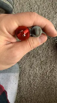

Yeah the shocks are big bore but they are meant for the ecx line of rcs

Those look nice. I have a mix of red and blue's coming for my parts list. If you don't mind after you run those for a bit if you could let me or the community know how they work out and what WT you use on your's?
I will look into those a little more I was thinking of going Traxxas brand due to more known of a name maybe a better made part? IMHO.
But I base a lot of my upgrade choices on the reviews of the part not the seller. if it is a well known part like castle motors per se I youtube reviews as well before I purchase.
I understand why you don’t trust the China parts I totally get that and I’ll tell you rite now I’m going to use a Losi 35 wt in the rear and Losi 30wt in the front but as for a review That’ll have to wait I won’t be running the rig till the spring because it’s super cold here in Toronto and lots of snow
