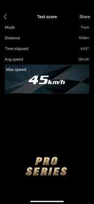

I had a few more rubber sealed bearings left from fast eddy but since I had downtime I got a spare set of Apex metal shielded and some lube. We will see if there is any difference.
Got the 3650 4300kv brushless in because I’m waiting on the 5mm pinion for the 3660 3800kv to arrive. The heat sink and fan wont fit on it and on a 21T it gets pretty hot. New pinion arrived next day (Robinson Racing 20T 48P 5mm). I had considered swapping everything to 32P but I want to figure out the motor and gear ratio we are going to stick with first. Everything is just in with zip ties right now, a deans to XT90 adapter and some 4mm banana extension wires. If you can’t tell I have some OCD tendencies and nothing is going to stay that way but I want to get decisions finalized before modifying stuff. I think we are still on the path to finish at 3S and the hobbywing 3660 motor and I’ll just turn it all down through the ESC programming card and the controller
Got a lipo bag. Trying to teach my son to do things with more safety in mind than I normally do. GPS telemetry arrived. Still waiting on the bracket I ordered. Zip tied to the front bumper app says 45kph (about 30mph). I’m concerned with practical speed that’s hauling ass across our property a mix of grass and gravel, soaking up bumps, etc. The best “stock”numbers I could find were 20mph but no context. What’s important to us is we can outrun the dogs teeth chasing expensive tires. It now power wheelies fairly easily. I can’t imagine on a better motor and 3S. Interestingly even on full hit from a dead stop with no dampening from the programmer or controller it doesn’t wheelie or spin the wheels from a dead stop. Maybe that’s a slipper or gearing choice issue. Not that I’m complaining dead hook and go is ideal
