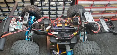

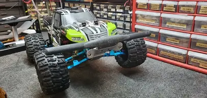

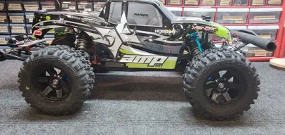

So here's my as of today, three auxiliary drone batteries. One for the front led lights, one for the high velocity fans and one for rear lights. Theres a total of four micro toggle switchs, one for the front leds, one for the high velocity fans, one for the rear leds and one for the main power. I don't like the little slide switch that comes with Castle combos. So what I do is cut it off and solder a micro toggle switch in its place. Now some of the other motor combos you have to use the standard switch, as it also has a programming button along side the power button.

I did have to modify the aluminum stand-off that that connects the the ball cups. It's a bit to long and has to be shortened. Again, the Amp is one heck of a Truck when its modified.

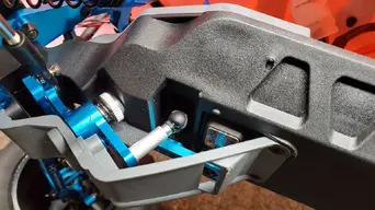

Here is the Traxxas turnbuckles I installed.
Three different sizes. I took the plastic camber links and steering arms to my LHS to match them up. Here is the result.I set the camber on the rear and used the inside holes to shorten the camber links as much as possible for more camber gain. The larger tires are giving me a higher CG and more roll so I set -3 degrees camber. I have not set camber and toe in the front yet. I am going with close to straight toe with a touch of toe in for high speed handling.
