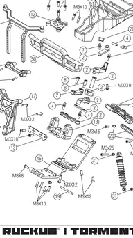

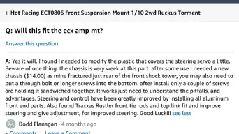

So I have been looking at hop-up parts for awhile. I havent bought any yet but I did do my research and apparently the Amp MT shares about 90% of its parts with the Torment and Ruckus. I would try Hot Racing part# ECT0806. I will post a picture of the part and a picture of a question asking if it fit an Amp MT where it was confirmed to work and not break on 30ft+ jumps. Hope this helps...

It looks like the Amp MT front suspension pin mount is 2 piece instead of 1 piece like the Torment. I still might try it myself regardless. Im sure it will require me modifying some of the plastic on the Amp but it doesn't look so far fetched.

2 more confirmations that Hot Racing ECT0806 works with modifications on the Amp MT.
