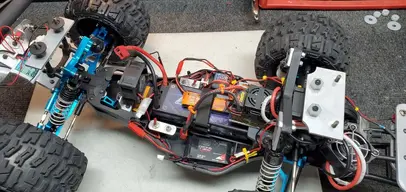

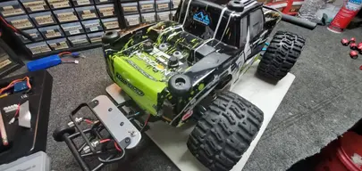

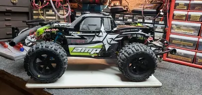

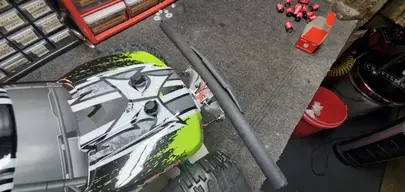

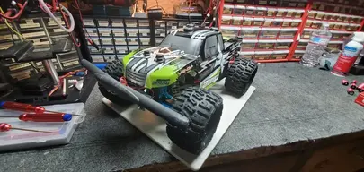

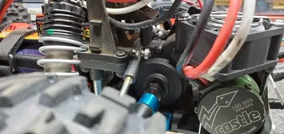

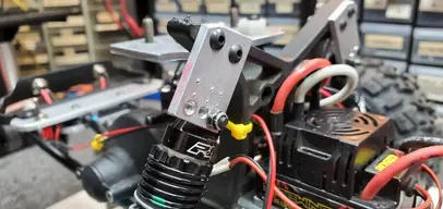

The Amp is a great truck when upgread. I have about 34 RC's a d the Amp is my favorite. Its been clocked at 65 plus. Here are some pictures.
20191231_154659.jpg20191231_154623.jpg20191231_154546.jpg20191231_154509.jpg20191231_154302.jpg20191231_154233.jpg20191231_154233.jpg20191231_154209.jpg20191231_153913.jpg20191231_154153.jpg
That thing looks sick!!! very nice job on the rear shocks by the way, it's nice seeing people go out of the box to trick these things out. these are a few pics of my 1/10 Ruckus. Still working on switching some parts over to adjustable or HR brand.

That's why I use drip system hose for the front bumper. It will hit the curb or whatever first before the wheels. It works as I have hit a lot of things when racing. There's a lot you can do to a Amp if you but your mind to it.
