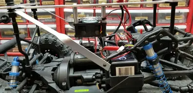

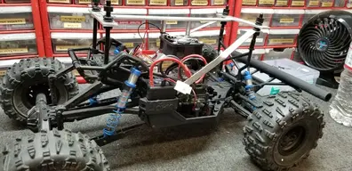

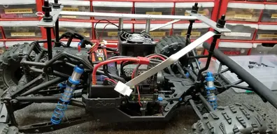

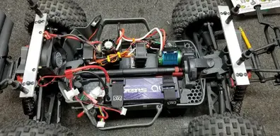

Welcome Matty, here is my AMP upgrades that i did on mine. This was my first RC vehicle and it moves, clocked at 60 mph. It has a Castle 4600KV combo motor running on a Gen Ace 7000 mAh 60C 3S Lipo battery. It Will do a wheelie for one block. Has all hardened steel gearing, including spur and pinion and CV'S . Has push buttons for high intensity lights and motor fan which runs on it's own Lipo battery. I put .99 cent plastic drawer handles on the top and on the bed to protect the body when and if It flips. It gets around 45 minutes of run time wit h the Gen Ace 7200mAh 60C LiPo. Have fun upgrading yours.

Weave - really cool light setup.

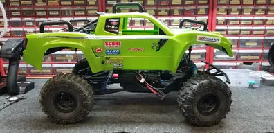

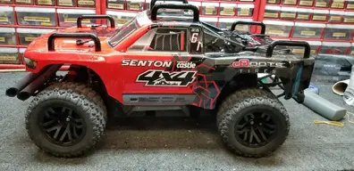

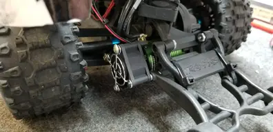

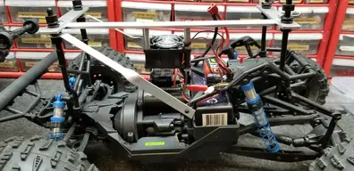

At half throttle the truck will brody around a corner instead of flipping but you have to have the right suspension set-up. I have other mods also, such as; brushless motor, all hardened steel gearing, lifted battery compartment for 3S 7000mAh 60/120 C Gens Ace Lipo and super cooling which is very important. I have 24 RC vehicles which I do a lot of experimenting with. One vehicle I have has 4 high flow fans on it some which runs on it's own Lipo battery.
Here is one of my upgraded 4x4's;

that green one is wicked cool looking! I'm running lock up mt on the front and rear and man what a difference. specially in the snow for a 2wd amp. I recently just ordered a castle sidewinder 5700kv motor combo from horizon. and I just installed the ecx rear aluminum shocks hoping my lhs gets in the front aluminum shocks so I can swap out the fronts...the only complaint I have about the ecx aluminum shocks are the springs. I feel they are too weak but I don't know still a newbie to the r/c world
You will like that Castle brushless motor, you will see a big difference in performance. Is the motor for your AMP, if so you will need a new radio/receiver as the stock radio that comes with the AMP won't work.
