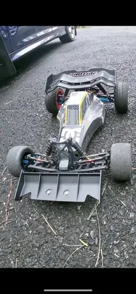

This was my second attempt at a front wing for this formula 1 inspired road set up. Used some aluminum flat stock to mount the rear wing from an aarma truck to the front bumper mount location.

Thanks Mate,
Looks awesome, although a little larger than what I am thinking.
nevertheless do you or did you notice any change in handling with the introduction of the front wing???
I'd be keen to know if you tried with and with out it.
I'm turning alright. I did add some weight to the front to help steering but have now removed it and am doing fine. Just after that little edge in keeping speed around corners.
Your rear wing looks magical. again awesome. Mine is all broken, yet still there, but I've always thought with the AMP being a rear mounted motor, is a rear wing necessary?? There is so much weight on the back already keeping the tires down.
Originally I tried the stock wing mounted as a front wing. That worked really well, the photo shows version 2. Both gave great straight line stability at high speeds. With version 2 the extra grip front caused oversteer. I was usually searching for more rear grip. It was a lot of fun to set up and learned a ton.
Lately I’ve been driving my amp db off road. Again found the need for a front wing and experimented with this one. It worked really well but wasn’t durable enough for off road.
