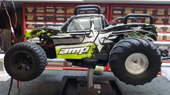

Just installed this servo/horn in my Barrage. It runs great, but after reading this I’m wondering if I should go back to the stock plastic horn. It’s a slightly better fit also. My weak link is now the steering knuckles and that’s $30 for the upgrade aluminum ones, compared to the cheap cost of a new plastic horn. I guess if the knuckles break, it’s a good excuse to upgrade. I want them anyway. So should I keep the aluminum horn, or should I use the plastic one?

That is completely up to you but personally I would get aluminum parts and keep metal servo horn for looks and besides with a servo rated for 20kg/cm you shouldn’t have to worry too much about torque problems just make sure you don’t turn while wheels are stuck on something you can really mess things up. I’m sure there are metal servo mounted servo savers that are Traxxas style, made by integy or something.

I went back to the stock plastic servo arm. It just lines up better. The metal arm caused some binding due to a lower and closer to the servo location of the ball. The actual servo that I chose is strong, and I like it.
