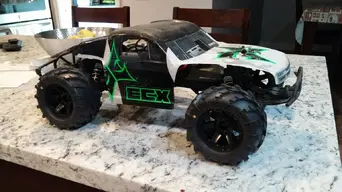

This is my Ruckus. I haven't had any issues with the body rubbing . I'll be replacing the body with a jconcepts BAJR body which has a similar shape to this . Do you find that the 10 mm offset puts more stress on the stub axle ? 0823170945.jpg

With that body you won't have any issues with the tyres rubbing. lol
I am running those on a torment so the wheels and tyres are nowhere near as big.
That looks like a torment, with big wheels right? I cant see any issues and dont foresee any

Yes, it is a torment. I found this truck to be a lot more fun with the bigger 2.8 Masher's on it. I have an affinity for monster trucks
