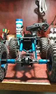

I just got mine in this week as well as the Hot Racing shocks. Can't wait to put them to work. They really stiffen up the rear and look 100 times better!20170310_201759.jpg
Wow those shocks look AWESOME! I need to get some of those!
They do look really nice, but they do need some slight tweaking for the tempers torque. They come with two sets of springs, medium and hard, neither are enough to handle the torque at the stock angle. The solution I did was to use both springs and add some diff grease to keep things moving smoothly.
I've converted my Temper into a ladder frame (short wheelbase version of a Barrage) and I'm running the shocks on the inside of the frame. Not having exposed springs would be a huge plus for me!
These sound perfect for that and you should be fine with the firm springs.

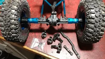

Im sure some of you are aware, but the ecx Barrage uses a very simular axle and they offer grey lockouts for them.
I was curious if they would fit on the Temper axle. There is a slight variation in the axles where it looks like there is a reinforcement (that extrudes from the axle) in the area where the screws go in (that would hold these in place) so I wasn't sure if the Barrage ones would work on the Temper axle.
Well dang it looks like those wouldn't work... My bad. Ive been doing a lot of research on the Barrage for a friend and a lot of people said they were the same, well other than that extension. BUT on a plus side if that actually does beef them up a bit it may be worth upgrading to the barrage axles down the road. Screenshot_2017-03-20-14-09-29.png
Yeah, I was thinking about upgrading to the barrage axles. Hopefully I won't need to. I'm going after the aluminum steering knuckles and hubs next.
Don't know if y'all are aware but the temper uses pretty much the same parts as the RedCat Everest 16.
Well they make Aluminum axle housings for the Everest 16. They look identical to the Temper.
Only problem is they are $94 PER axle (and that's just the housing). Here they are at Amazon.
