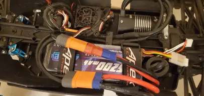

Playing with 6S the smart way...
HW 2600kv 5mm brushless sensoreless motor;
BLX185 (HW QuickRun) aarma outcast esc = punch set 1 of 9;
2x 3S (25.2v) 5200mah 50C ec5 in series
and most important...keep it smooth and progressive to avoid stress...
Full steel drivetrain necessary.
Steel 45T 1.0 mod spur (lightly brushed with White Lithium Grease)
Steel 14T 1.0 mod 5mm pinion
Outside test @ 1/6 throttle was ... very fast and smooth. No need to slam throttle...so...much...torque

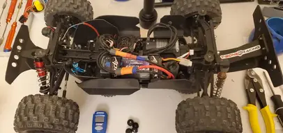

Aarma Talion 6S 2019. 16mm. 4mm shaft. 35wt shock oil.
Ecx alu shocks... probably need to upgrade as my rig weighs 8.75Ibs with 4S and 9Ibs 1oz with 6S llol. And it's really rated for 5.5-6Ib rig...

All right.... stoked. FINALLY! Just replaced and upgraded rear shocks with red Outcast 6S front shocks... wow such plush smooth perfect dampening for a 9Ib rig! And... max rear travel restored. Now i need to work on my TALION 6S front shocks... from 35 to 60 wt perhaps and longer springs? Dampening too bouncy....
Transferred my gold ecx alu shocks rated for max 5Ib. over to my son's 2wd reinforced 2S/4000kv SW4 ecx rig much needed torment 2wd. Excellent rebound.

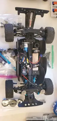

still carefully Frankensteined this 4.5Ib Brushed 4x4 into a 9Ib 4S Brushless monster... since Apr 7 2019.
PS2 Expert accessing my way around my 4x4 Monster Torment .... best part of learning this hobby = what doesn't work lol

Thanks for the pics.
Got a bit of clattering myself and wasn't sure of the easiest way to access the diffs.
Thought taking the whole top off the suspension was probably it, looks like it is the only option.
Also your homebrew mud guards inspired me.
5284
Lol... mud-rock guards were before i totally trashed the sct body and upgraded to the proline brute white bash body btw 3x thicker and works...and 2.8 MX wheels.....
Essentially yes.
¹... remove slipper cover after loosening motor top plate
²... remove chassis top brace
³... remove wheels
⁴... disconnect shock bottom screw
⁵... dis connect turnbuckles
... i know...tons of screws lol
⁶... remove gearbox with shock tower to access diffs
Voila. Pita to work on. Aarma/Proline/Tekno soooooo much easier.
Hope this helps. Because i no longer stress when i need to service check all.... do it moreorless blind.
