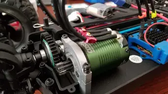

I'm running a 3s lipo on a 4x4 ruckus with a castle mamba and a 1415 2400KV motor and a metal spur gear (the stock one melted within minutes), everything else is stock.
I started with a 2s lipo and a sidewinder that i had lying around but since the motor was like 5700kv it didn't last long lol

no problems yet, but i have not used it much.
