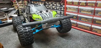

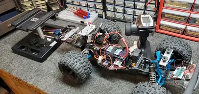

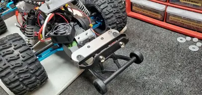

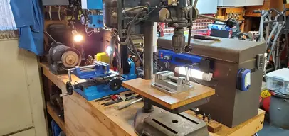

Kaden, I've run the 3800kv and 4600kv in my Amps and have not had any problems. I do install high velocity fan's on the motor to keep things cool. The fans run on their on separate dron battery, 7.4v @ .800 to 1mAh. The batteries are also switched. I also run Pro-Line Trenches, so we been clocked at times of 50 to 60 mph. Below is my shop were i do all my mods. The Amp is a great truck to upgrade and as you can see the upgrades are endless. 20200415_161201.jpg20191207_163903.jpg20191231_154135.jpg20200522_171114.jpg
