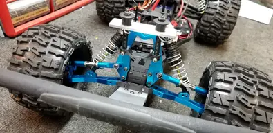

Hit racing front alu steering brace + hr alu servo saver and 16mm aarma 6s front shocks make it quite bullet-proof. TBone front - rear bumpers also major player. 17mm alu wheel hubs....

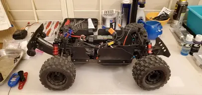

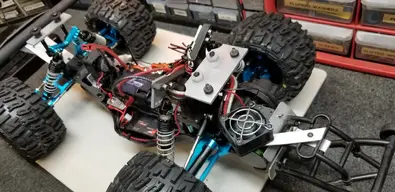

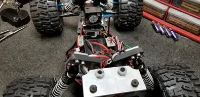

View attachment 5210View attachment 5211

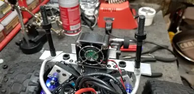

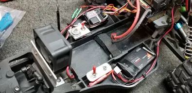

.. BLX185 ctrl 4S 50C in series HW 2600kv 5mm front Talion 6S shocks 1:4 diff ratio...45T/14T 1.0 mod white lithium greased. Very fast...very smooth. So fun.
PS i did slightly bend rear 2.5mm shock shaft.....lol.

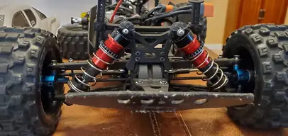

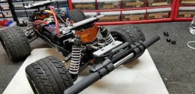

Wow.... super smooth front Outcast 6S shocks onto rear....plush. replaced front Talion 6S shocks from 40 to 80wt. Very balanced now at speed. 9Ib rig needed it. Controlled 2ft landings too. Fun
