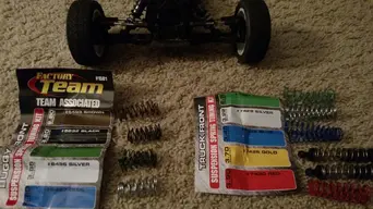

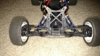

so I got to try some 2" associated T4 2.99s (green). 2.99 is definitely stiffer than the stock front springs. The lightest losi spring at 2.5 is probably on par with the stock spring? Seems like I'd be looking for something 2.0lbs or less. I currently have 30wt oil in all 4 corners. The light front end on this buggy really wants to bounce around with it's stock springs. I could try a B4 front shock tower, I don't know how much info we have on that.
The B4 front shock tower does fit. You would just need to mount some B4 shocks (or something with similar dimensions).
The ECX Boost's front shocks are so long that you can get away with using the Losi 2" long springs so then you could (if you can find 'em) use the pink/2.3 rate spring.
I can't remember if you mentioned that you added weights to the front or not. If not, add some stick on weights under the servo arm.
None of this will truly solve the Boost's front suspension "issue" as the car is fundamentally flawed. As I mentioned in another Boost thread, the buggy was simply a repurposing of much of the Circuit ST platform: it has shorter suspension arms and a shorter chassis. The front shock tower is the same as used on the truck so the suspension arms are going to have less leverage. :(
