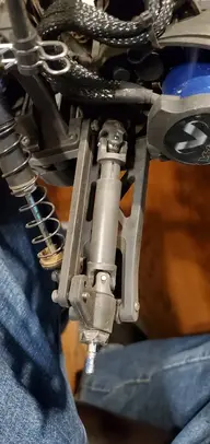

Im seeing a lot of posts asking about the best driveshafts on the market. Most reply with HR traxxas or some off brand. MIP are by far superior to HR or plastic alternatives. The metal and machining are on par with the highest quality tool steel. I have a lot of tools and MIP are like the tools your grandpa used... still working. They will outlast your car. Dont use grease, it will act like a cutting compound. Dry lube and locktight. You will need to mod RPM hubs but its extremely easy if you have a dremel tool and a sanding bit. Install the driveshafts, compress your suspension until you see where the axle is hitting the wheel carrier. Use a marker to show where you need to grind, pull it apart and grind away some plastic. Keep doing this till the wheel moves freely when fully compressed. Took me 3 tries per side or about 15 minutes per side.

The only issue some have with the mip, is the limited angles they can run. I actually swapped my a arms left and right so my driveshafts actually go straight from transmission to the wheel hub, instead of going forward and down (mine still go down, but not forward). But yeah, i have several trucks running MIP for a few years now, no issues yet. Thier warranty is useless though, had an issue with a tool, a manufacturing issue, and was told to go pound sand. So I am no longer a supporter of MIP, which they are the only ones who make such quality driveshafts, so kinda blows, but there are better tools out there I've found at least.

That sucks to here about poor customer service. Im looking at my car right now and i see what you mean about the angles. I wasn't aware that there was any difference between stock and MIP. I'll go out on a limb for them and say that I can only imagine what they have to deal with in the customer service department. They are selling something that requires a lot of modifications that can lead to a lot of problems. Binding issues in the wheel hub, compatibility or part #'s, proper alignment of the pins, set screws coming loose because the customer didn't use locktight... its hard to stay level headed when your customers don't know what they are doing. That being said, I didn't know about the angle difference. This should have been noted somewhere in the part description!
