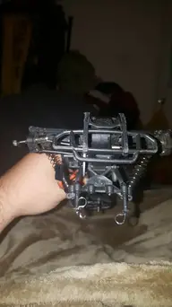

    Well since i mentioned this section i figured i would make the first thread on it. So i picked up a ecx smash off of Craigslist about a month ago and withing the first week i killed the motor and thus lead to the start of what is going to be a 50mph(yes you read that right) quest.
    So far I have stripped it all down and am just looking for parts to replace stock ones. I would really like aluminum parts but we will see. I think i have found some from the Losi micro-t that i can use but we will see. As for motors its between a hobbywing or castle creations brushless system just trying to figure out what Kv to go with. I'm going with hot racing 56mm shocks and i also got some different tires on the way.

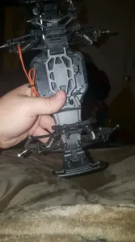

    Yea i actually just got it back up and running this weekend. I went with a 7800kv motor and 18a esc from hobbywing.

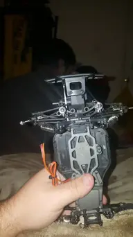

    I didn't get to run it much because it spun the tires free from the wheels. So now i have to reglue them or just get new ones.
