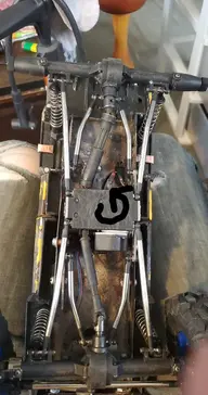

my plastic Driveshafts for my Temper Gen2 snapped on me. I have ordered 2 different metal sets that won't fit on the rc due to clearance at the knuckle and the stock plastic ones are on backorder until December. Does anyone know of a set that actually fits and works without having to make modifications for clearance? thanks

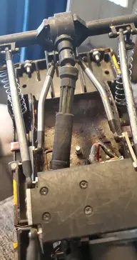

Axial wraith shafts work great just need to cut a little of your trans case and cut them down but you will never break themUSER_SCOPED_TEMP_DATA_orca-image-1580238279990.jpeg
@Spryguy420 , when you say you need to cut a little off the trans case, are you referring to cutting a little off the edge of the skid plate that is screwed into the trans case? In my case the shaft that broke is for the rear wheels, so I fear that a thicker one will interfere with the gear cover at the back of the motor. Have you replaced the rear one as well as the front?
