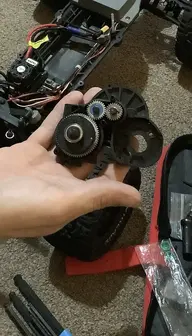

Just a general post just locked the diff in the 2wd ruckus. Gunna add some stress to the gearbox I imagine so looking into spur and pinion upgrade. This is what I have done to help along the way

Have you had any issues with the gears striping even with the metal ones cause I put them in my torment 2wd and I've noticed they have a lot of back lash
no Problem with the metal gears at all i thought the same a lot of backlash. It’s the idle gear that will go first but they’ve been in there for months with it breaking everything around gears like hexes driveshafts and obliterating bearings So I think the gear set held up quite well. Can’t fault it. Defo get some metal driveshafts if you haven’t already

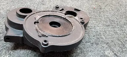

Imnoexpert Rc, on the spur gear shaft, place a shim over the bearing. There should have been one on it when you took the plastic spur off. It helps to keep the heat away from the motor/slipper housing that is caused by the slipper plates. Below is what will happen if the shim is missing, especially if you run with a semi-loose slipper clutch or harden steel spur gear. The slipper clutch plates get very, very hot. This was caused by a semi-loose slipper clutch maybe to lose, none less, it's better to be safe than sorry.​
