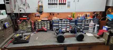

Hope this helps you somewhat, upgrading, repairing, racing, bashing, and just having fun. Happy RC'ing20210710_090437[1].webp20210710_091426[1].webp20210710_094715[1].webp20210501_175518[1].webp

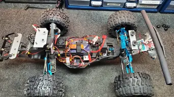

So Net, you're saying the chamfered area of the holes is elong-gated, that's what I see. it looks to me like you might want to move your motor to a different set of mounting holes. Move it away from the motor guard. To me, it looks like the motor is pushing against the motor guard, thus pushing it outward. If the holes are stripped, tap them out to an M4 x 0.70. Drill in just enough to start the tap, about 3/16th, and tap the hole 1/8 in, then let the M4 socket head machine screw make the rest of the threads. It's a pain to change out that bottom plate, it can be done, but faster if you have the proper tools. I made a modification on that part so it would easier to remove the suspension pins. The small holes are there to push out the suspension pins with a paper clip or a straight pin. Hope this helps out some what.

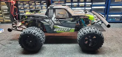

G'day,
Can't really help on the engine mount issue, but I have tried some different wheels out, on the Amp Buggy at least. See images, one shows the difference in size from the original front wheels to the new ones. I'm currently using 1/8th proline rims with the 1/8 buggy proline badlands with of course an axle adaptor for the 1/10 to 1/8 issue. I found the ECX wheels to be very strangely too big of normal 1/10 but a little smaller than 1/8th. Anyway, all good with these, faster and great grip.
Good luck.
