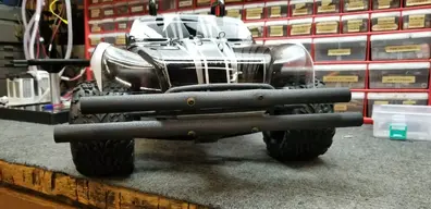

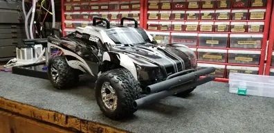

Ron, that is a common mishap when you hit a curb. I don't know how mechanical you are but there is away to prevent that breakage from happening again. This is my Torment with a different body, I installed a mod bashing bumper on the original bash bumper. It's 1/2" ID Drip System hose $ 1.99 for 2 2ft. As you can see from the photos the bottom hose is a little past the wheel base. You can cut the hose if it interferes with your steering. I use a PVC cutter, and cut at an angle as needed to clear the tires. I ran my truck at half throttle into the curb and it bounced straight back without any breakage as the the truck hit the mod bumper (hose) instead of the tires.
