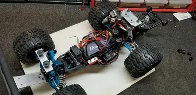

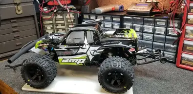

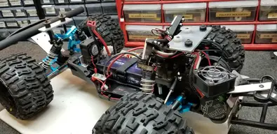

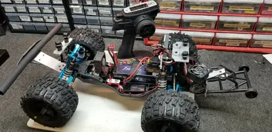

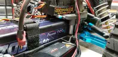

Welcome to the hobby Treeman, good choice for your first rc. My first rc was also the Amp five years ago, great truck for newbies. It definitely dose not look like the Amp I bought fives years ago, it's been totally upgraded to the max. We have 29 rc now, I'm starting to loose count (just bought another DHK Hunter today) but my Amp is still my favorite. Have lots of fun.
