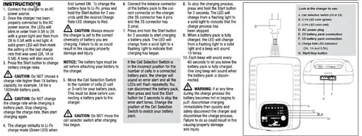

Now while I am reading the manual for the charger, it says it defaults to Li-Fe setup, I assume you are doing it correctly, are you setting the parameters on the charger before you hook it up? Setting it for Li-Po's not Li-Fe's, and the correct cell count?
Now it does also state that it will remember the last charge setting, but if it's been a while since it has been used, make sure it hasn't returned to default.
Easy answer, without purchasing a new pack or charger, you could get a cheap cell voltage monitor and check the individual cell voltage.
