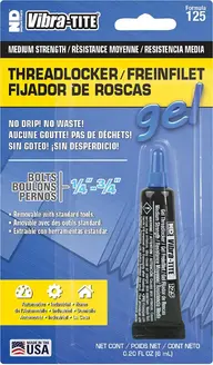

I've had lots of issues over the years with wheel nuts not holding. Most of the time it's the left side that get loosened. Sometimes, the nylon locking ones are only good for a couple of loosening/tightening episodes IMO. Even flanged serrated nylon locking nuts have loosened on a couple of my rides.
Vibra-TITE 125 Removable Medium Strength Gel Anaerobic Threadlocker has been my best friend in the fight against loose nuts :LOL:. I haven't lost a wheel in years since using the gel thread lock. Small tube of the stuff will last me at least a couple of years.
When I finally use up all my Loctite blue stick I've thought about trying out Vibra-tite. Just wish they offered a stick form as well.
