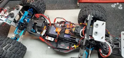

PS : i want to install it in a circuit (my car) to transfer the circuit servo to the AMP (my son's)
RC_Noob, while your at it, think about changing out the servo saver as well. This is the one i put in my Amp and what a difference it made in my steering along with my Savox servo.

I have ordered aluminum parts and servos from Banggood. They will take a few weeks to get here. For the servo saver I put a small zip tie tight around it and it made a huge difference. Here is what I have on the way for my Amp MT.
