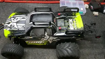

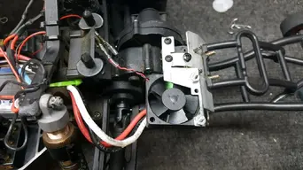

FDNavy, thank's for your service, I have an AMP it was my first RC and now we have 22 1/10 scale RC's. The AMP is a great beginning RC for kids and even better when upgraded. There is a lot of good ideas here for upgrades, but I must say, the best and first upgrade should be to trash the brushed motor. I know you want to stay at $ 100, but there are some great buys on EBay for combo brushless motors, combos meaning the motor and ESC. The only problem with the AMP is you will have to get another radio when you go brushless ($ 40 to 60). Depending on how your son uses his AMP, you will go through a few brushed motors at about $15 to $20 a shot. The brushed motors don't last that long and do get very hot, although you can install a fan but it takes some designing techniques. I went through 4 motors before I realized I could of bought a combination motor and ESC for the money i spent on brushed motors.
I have nothing against Horizon Hobbies, there a great company and have super customer support. So, the GoolRc 4900KV with ESC is around $39 to $40 and you have money's for the new radio ( which comes with the receiver) on EBay , it's not the best motor combo but it will last longer the the stock brushed until your ready for a better motor upgrade like a Castle 3900KV or 4900 KV at $110, less if you get it on EBay. The only problem with the GoolRc combo brushless is you will have to get the program card with it in order to program the ESC $12 , sometimes you can get all three together on EBay. This is only my opinion and like I mentioned, there's a lot of good info here from other users. Hope everything works out.
