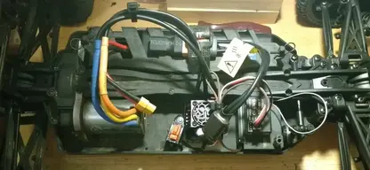

Savox SC-0251MG slots right in. Had to loosen the screw to the pushrod to stop the horn from bending.
BLX100 esc kinda fits. Used some spare screws that came with the Savox to mount it to a couple of posts on the plate. Not entirely convinced that arrangement will survive.
Also not super happy about the wiring flapping around. Looking for fixing points on the torment but not seeing much.

The screws from the old ECX bumper/bulk were the perfect fit to hold down the ESC nice and snug.
Drilled a couple holes in the servo mount to affix the esc switch.
Wiring tidied up a bit.
Reckon I'll be bashing again this weekend.
