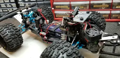

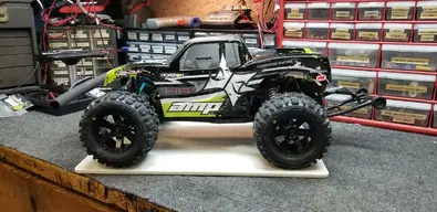

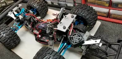

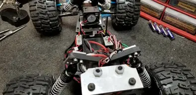

Ivan, this is my Amp with Proline tires, $ 26 a pair. Great tires and use them for racing on dirt and asphalt, also do some jumps. Have a few other upgrades n this vehicle.
20190108_163139.jpg20190113_200425.jpg20190108_163305.jpg20190108_163509.jpg20181205_200439.jpg
Badass truck dude! I'm going to have to check out those tires, your suspension looks nice, how hard was it to upgrade it?

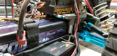

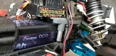

Not hard if your mechanically inclined. Some of the aluminum parts I made myself. Below are the identification of the tires. I use GenAce 7000 mAh 3S batteries on my vehicles. On the Amp you have to raise the battery compartment for a 3S battery. The truck does 65 plus if you can keep on the ground. It's a great truck for upgrading. I have three fans on it, two 5 volt .50 amp running on a separate 7.4volt battery to keep the battery and motor cool and the stock fan for the ESC.
