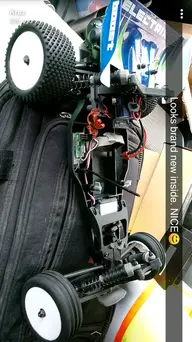

And here is a pic of the awesome buy I got used off of eBay. I will be upgrading it to the max for what is aloud per say.
This will be ran at 2 different club races this summer if the classes cross over.
