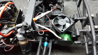

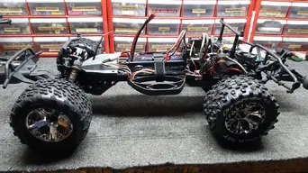

Kyle is right, you would be better off with a 2s LiPo battery and larger pinion. To answer your question no ut wont get any hotter then what the motor runs. Brushless mortors run warm anyway. I put fans on everything that gets warm just to.be safe, call it over kill if you want.
