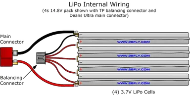

You can check the voltage on each single cell with a multimeter on balancing connector
