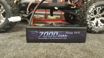

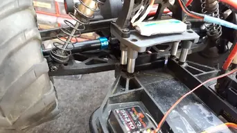

@ddxxe, this what i did with my AMP to accommodate a thicker battery. I run Castle Brushless motors (4600Kv to 5700Kv) in all my trucks and had to raise my battery compartment with aluminum stand-off's. I did this with all my trucks and also use battery straps. The battery i use i the GEN Ace 7000 mAh 60C/120C. Use your ingenuity and creativity that's what this hobby is all about. Happy RCing! See the thumbnails

@weave where did you get the standoff's at? Would like to get some as well - type size brand? Or link to where you bought them would be great - thanks.
Trupix, we have a used electronics warehouse here in Santa Clara, Calif. called Halted, here's the web address; http://www.halted.com/commerce/index.jsp. Once you get there, click on All Products and on the right, click on Hardware and Stand Off's. I believe you can order online from them. However, you should be able to find these parts in your local hardware store, Home Depot, Lowe's, ect. Any type of aluminum, brass, nylon, plastic or ABS tubing should work has long as it can accommodate a 3 mm or 4-40 to 6-32 screw. Depending on the length of the stand off you use, you will have to increase the length of the screw. I hope this helps you out.
