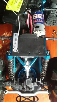

Moving the shocks to this outside position helped me greatly with torque twist and overall handling with the added 15mm spacers and 2.2 hammers0103171950.jpg
