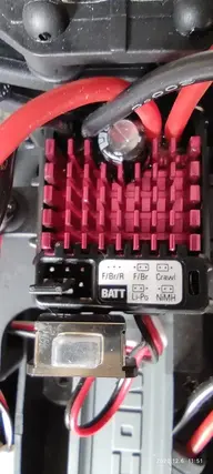

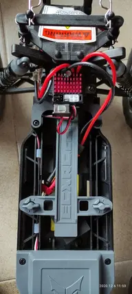

I attach some pictures because of my settings so that you can let me better understand what you mean when you say "turn the brake setting up on your esc". If i set throttle 100% and I brake it already runs properly.
My problem is that we play in a very small area so we need a really small velocity but a great amount of brake to not hurt. How can I solve this? I saw on rx an AUX empty plug. Could be helpful in someway?

Most ESCs are programmable and you can change how much motor power is applied when you hit the brakes. The stock one on your trucks is not. For a 2wd truck 50% brake force is likely how the ESC is programmed and you can’t change it. If your brake force is set to 50% and you turn your throttle rate down to 50% you will have no brakes. You can fix this by turning your throttle rate up, but if you don’t want to do that I have a solution for you.
Put a smaller pinion gear on the motor and turn throttle up to 75 or 100. This will keep speeds down, ensure the motors run cooler and you’ll have brakes. ?
I don’t know how many teeth are on the stock pinion, but get a set of 10-15 and you’ll be fine.
