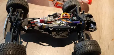

Hi People,
I'm Joost and a couple of weeks ago I bought me a second hand Ecx Amp monster truck. Which is actually really nice. I put on a motor from a airplane from a colleague of mine because my motor was damaged.
Now it's a really nice car which can drive on 3s and haves a lot of torque.

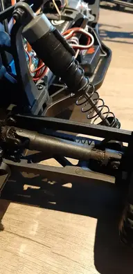

For this reason I'm looking into changing the drive shafts which are from plastic into metal.
I searched a little bit on the web and found a HPI e fire storm roller.
It looks like a lot of parts are similar or the same. Is there somebody who can tell me if I can change the driveshafts into the once from HPI which are made from steel?
Or does somebody which one from steel will fit (also in case if I need to change a little bit more)

Don't know if HPI parts fit.
Here is a steel direct replacement though.
Hot Racing HRASECT288X06 Drivshafts
The rest are other upgrades you can think about getting.
Traxxas 3643 Turnbuckles for front & rear
Traxxas 3644 Turnbuckles for front steering
Traxxas 3678 wheelie bar
ECX9001 Metal trans gears
RPM 73492 Servo Saver Eliminator
Fan & heat sink
Hot Racing HRASECT887 Spur Gear 87T
Hot Racing ECT0806 Front Suspension Mnt
Hot Racing ECT2806 Front Shock Tower
Hot Racing ECT1906 Caster Blocks
Hot Racing ECT2106 Steering Knuckles
Hot Racing ECT2206 Rear Knuckles
RPM 70582 Front Arms
RPM 70462 Rear Arms
RPM 70672 Gear Cover
