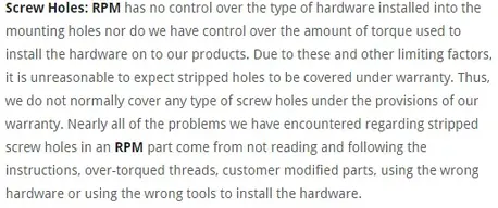

@WoodiE and @i_r_beej. Unfortunately RPM's warranty policy seems to explicitly state no warranty for stripped threads.
http://www.rpmrcproducts.com/faq/rpm-warranty-policy/
Still, RPM is a great company. I wouldn't be terribly surprised if they helped you out anyway.
Well you learn something new everyday. I personally can't say I've ever had a problem with stripped threads using RPM products, but I never knew they had this in their policy. Makes sense though.
The stripped holes was a bit of a surprise since I'm always very careful about threading screws into plastic. As I mentioned earlier, upon initial installation the ECX ballstuds threaded in with very little resistance leading me to believe that the bore holes were slightly too large a diameter. And very likely the reason why the ballstuds would work their way out. I contacted RPM about this and their reply was to use CA as a threadlocker.
I think that when I tried to remove the ballstuds, the glued screw shaft destroyed the shallow threads cut into the plastic and effectively reamed out the bore hole. (The ballstuds working themselves loose probably caused plenty of damage too.)
I honestly have no interest in contacting RPM about this. The original fitment of the ballstuds was suspect and I should have just secured them with a 4-40 nut in the first place.
I'm still running the rear axle carriers and all is good for now. :)
