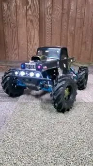

Last October I bought an AMP. Well a year later I figure I'd show you all where it stands. I changed my radio to a spektrum DX5C / srs6000 reciever with AVC.... awesome.
JConcepts Bog Hog Body Cosmic( Green blue purple) Colorshift with gold trim.
IMG_20181212_161711_309.jpg castle sidewinder on 3s, King shocks, Associated/Traxxas steering/camber links. ESS Dual And hot racing sway bars and everything else Blue. 20181218_094014.jpg20181218_093946.jpg20181218_093904.jpg I dont like these slash wheels with this look tho and cant wait to put a set of Jconcept Fling King rice and cane tires on this bad boy.and for the body mounts and side panels I made them out of a plastic product called polymorph. Stuff is clutch for RC parts. Also shout out to Sugru moldable rubber glue.

Yeah those fling kings are gonna look sick with that body. Going to have to avoid tar and concrete with them. How are the dual rear shocks?
How do you like the king shocks? I have the ecx aluminum with i think 35w oil all around, I might need something a little stiffer in the rear though.
I'm liking them. I heard they leak so after I filled mine. I put Yamabond on the last threads so they are sealed. I honestly forget what oil I have in them i want to say 25 or 30 in the front and 35 in the rears.
The dual rear shocks are good but you have to mount ome set upside down due to tire clearence issues. I think it handles well. It jumps nicely as well. I have another set of shocks that are smaller lying around but there's no way to add dual to the front.

So with these giant new meats I blew apart a rear wheel bearing within an hour. To be fair it was clicking. But long story short. Upgraded thenrears to 5x11 bearings and corresponding hubs. I honestly like the angles with these knuckles better.
