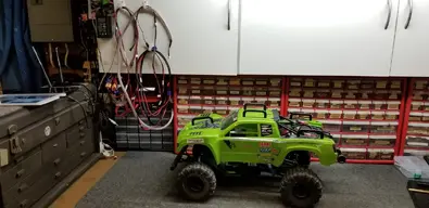

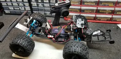

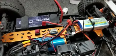

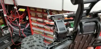

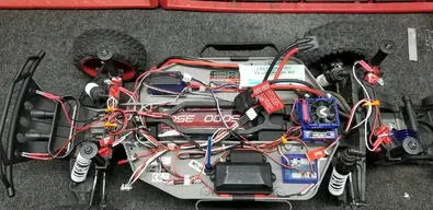

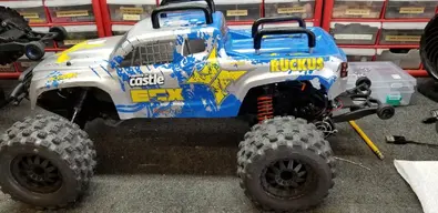

Hello Rockstead, yes that part is a common problem that you are experiencing. The question is are you able to replace the part yourself? It's fairly easy to replace that part, but, it takes some time to replace it. I can tell you step by step, but I'd be writing a book as more then a few other parts need to be removed. I would recommend to go online and download the parts view for your Amp, Torment, or Amp Crush, the rear suspensions are the same accept for the rear bumper and bumper parts. As far as the reverse wobble goes, that's a common with the Amp and other ECX entry level vehicles. You can eliminate 70 percent of that wobble by upgrading the servo saver. You ask about upgrades for your Amp and I can tell you there are a lot. The Amp is a great MT when its upgraded, its just about what you want to do. Here is what I have done to my and others that I have. As you can see the possibility's are endless. Oh, and I'm 75 years old and kids are always calling me, "lets go race" and I'm outside in a flash. Enjoy the hobby Rockstead, it's a blast and lots of fun.
Screenshot_20190109-164724_Photo Editor.webp20180313_170721.webp20180411_174758.webp20180418_140932.webp20180513_164554.webp20180522_182519.webp
Part#'s for a few upgrades.
Traxxas 3643 Turnbuckles for front & rear camber
Traxxas 3644 Turnbuckles for front steering
Traxxas 3678 wheelie bar
ECX9001 Metal trans gears
Hot Racing ECT4806 Steering Bellcrank (Best)or RPM 73492 Servo Saver Eliminator (Good)
Fan & heat sink
Hot Racing HRASECT887 Spur Gear 87T
Hot Racing HRASECT288X06 Driveshafts
Hot Racing ECT2806 Front Shock Tower
Hot Racing ECT1906 Caster Blocks
Hot Racing ECT2106 Steering Knuckles
Hot Racing ECT2206 Rear Knuckles
RPM 70582 Front Arms
RPM 70462 Rear Arms
RPM 70672 Gear Cover

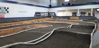

I doubt they will bend, I race on our indoor track which is asphalt and have never bent my aluminum suspension arms. They are very heavy duty. They are 6.06mm thick shy of being a 1/4 inch. I can't even bend them with my hands, and believe me I have tried.

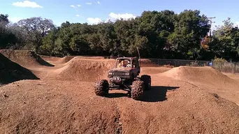

I know they will bend. It's not if they bend its when they bend I have to spend $50 to replace instead of $20. It's not cost effective for me. Unless you have run our track I am sure you wouldn't be able to appreciate the size of the jumps.Screenshot_20190826-080449_Video Player.webpScreenshot_20190826-080407_Video Player.webpScreenshot_20190826-080257_Video Player.webp
Yes your right, that is compacted clay dirt. So Rockstead, so in the images are some of my old plastic suspension arms. If you look closely you will notice the hinge pin holes on the right are elongated from jumping at are RC park. Our jumps are anywhere from 5 to 6 feet plus in the air and some time over the chain link fence, at full throttle. I was constantly changing out front and rear suspension arms, to the point where I would stock 6 sets for repairs. Now I have my own hobby shop and stock all my own parts. Since I have upgraded to the Hot Racing arms I and my customers (the kids and some adults) we don't have the above problem anymore. We have never bent a Hot Racing aluminum suspension arm. Not saying they wont break, they are an aluminum alloy and could snap if hit the right way, but bend, no way. Anyway like i said in other posts, I'm a retired machinist and make some of my own parts and am in the process of modifying the plastic suspension arms to use the Traxxas and DHK screw-in hinge pins. I machined two sets (front and rear) for Torment and they seem to be working out just fine. So what ever you upgrade too, enjoy the hobby and have fun.
