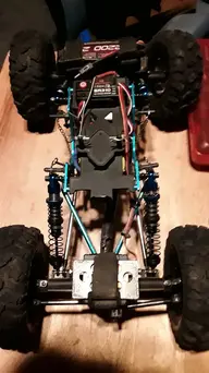

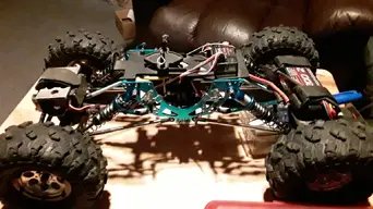

Hello! I'm new to crawlers but have other TVs, saw temper in LHS thought it was cheap enough to try crawling. It's fun!!
So far I moved upper shock mounts outward,put lipo under esc, added weight and removed foams from wheels, added shock oil,removed front bumper and mount, I tell you I don't know what mod did it but I eliminated almost all of the torque lean! Next I want to add 4ws,but having an issue trying to find mount...thx for looking.20181101_131032.webp20181101_131032.webp20181101_131032.webp20181101_131041.webp20181101_130953.webp20181101_131023.webp20181101_130959.webp20181101_131015.webp

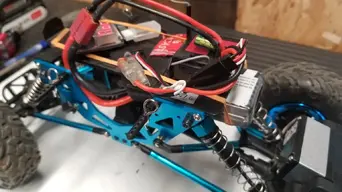

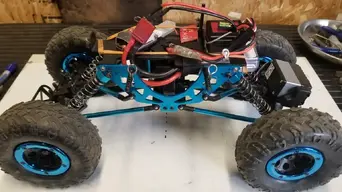

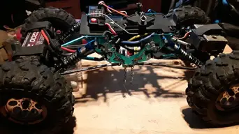

here you go bro there's pictures of my modified temper as you can see I've added outboard verraterra shocks and put all the running gear and motor from a barrage Doomsday aftermarket Rock Beast tires LiPo battery and have the ability to mount the battery on the top battery plate or on the front steering or on the rear axle the mods that I have made have turn this little temper into a completely different animal than it came stock and now has the ability to turn a perfect donut like a monster truck and sometimes on steep incline so I can get it to do backflips with the power of the brush motor on lipo I've kept foam in my tires and have added no weight to them.

Nice! Did a few more mods myself, went with traxxas xl 2.5 esc and receiver/radio (had onhand) rear steer servo, I'll post pics later.
