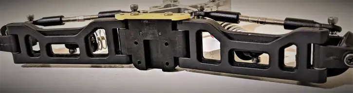

Second pic... I toyed with leaving the ESC under the old ESC mount but, not enough room for the fan to draw in air and after feeling the difference in chassis flex the old esc mount is performing double duty as a rear chassis brace. I will post some pics of the body later as well. Just noticed I haven't taken any since it's been trimmed. As well these pics do not show the minor body mount mod.

I finished up a few other little things tonight. I changed some of those pivot balls in the traxxas links to all of the regular type Traxxas balls with no spacer/sleeve that makes them sit on a funny angle when installed on this car and I boiled the hard plastic speedtreads off the 2.8 rims so, I can mount other tires on them. I'm cheap and wanted to reuse the rims for a softer set of tires. Wheel and tire prices make me want to run a loose slipper and a Johnson 540 motor lol
For anyone wondering about reusing wheels - I had good results but, it's sort of a pita. I found breaking the glue as much as I could while the tire was dry and then boiling them for 5 mins each side yielded the best results and least amount of effort to get the tires off. Don't mind the pic, I still need to clean up the bead area on the rims before installing the new tires, Duratrax runs a full bead of glue around their tires but, luckily these came off pretty clean!

Here are a few more pics of this project. I feel because of the 5862 shocks being a little shorter the truck has become a little more Truggy than MT when it comes to suspension. The suspension is plush, I have lots of body roll like I intended and plenty of droop with lots of travel still to go. Thanks MaX-D for steering me away from the ECX shocks.
