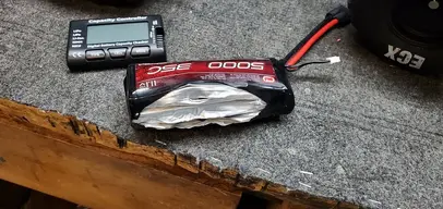

Massey, this is what happens when you over charge a battery. Although this is a Lipo, the same can happen to NiMh. It's best to charge one or two amps under the rated amperage. It may take a little longer too charge but it's safer and your batteries will last longer.
