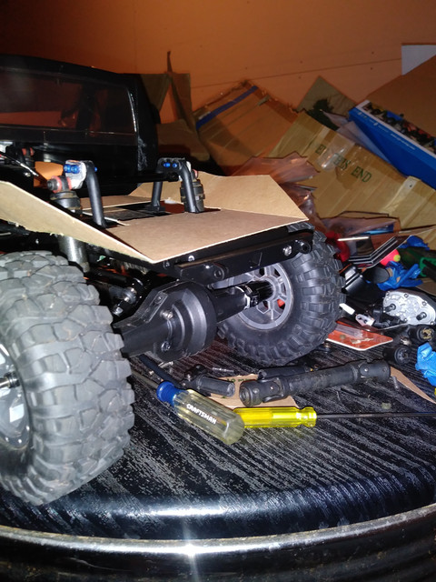

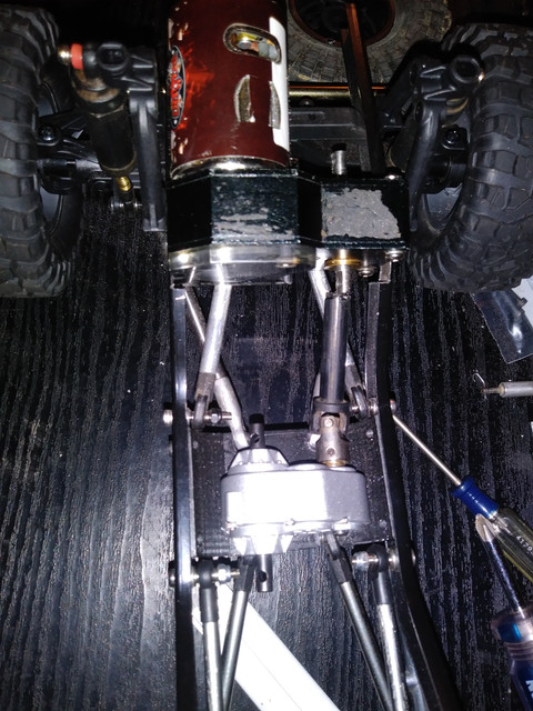

Easy swap just need to swap axle side rod ends with traxxas 1942 rod ends. The barrage has 3 mm set screws in the links for the rod ends. And replace the chassis side uppers too to rid of the ball stand at least my gen 1 was that way.

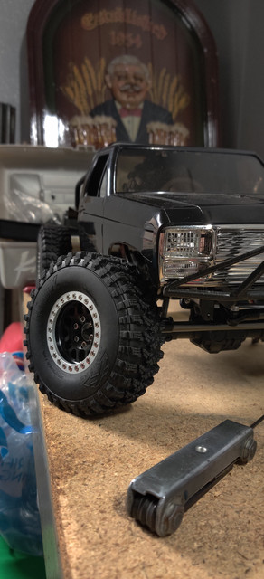

Nice, thanks for the advice/info. Your build is looking sweet. Are those some RC4WD parts ? I’m pulling the foam out of my lil Mud Slingers. The RC4WD wheels are so much easier to assemble without the foams. I was thinking I’d get more grip. These tires are only 3.6 inches so I’m not worried about the sidewalls collapsing. I’ll give it a try and if I don’t like it, I could put the foams back in, or get some different ones. Closed cell, or two stage soft. If anyone even makes a crawler foam for tires this size. Also, I didn’t vent the tires or drill vents in the wheels so they are sealed with trapped air inside. Seems better, but the trail will tell.

Yes those are rc4wd parts.

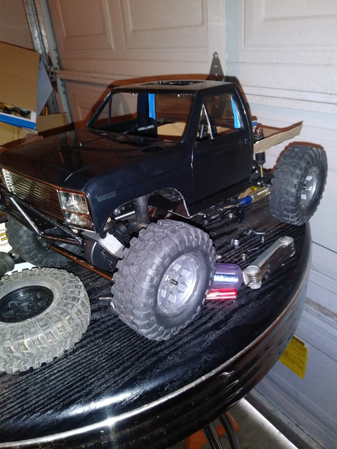

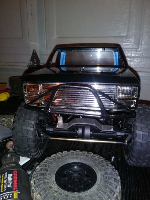

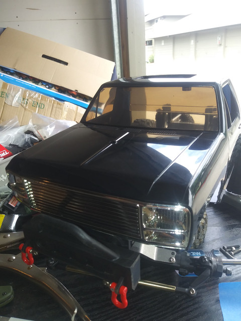

Chopped down stock front bumper
Scaler fab pre runner Rubicon front bumper
Wertymade 4" rear bumper
Nice little bumper and the plate that mounts the bumper to the chassis has some weight maybe help even things out.

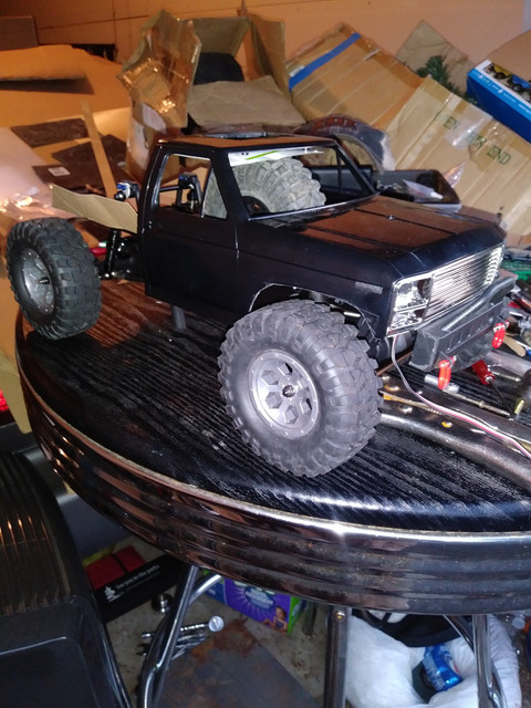

Starting to look like something
