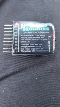

Picked this up along with the Venom. It was around $7. I already plugged it in. Reads 3.84 for each cell which to me means a storage voltage thereabouts.

Yep that’s it. 3,85 is storage voltage so it has bled down a tiny bit. There is a button on the end, push it until you get to the voltage you want to alarm at. Mine is zip tied tightly to the battery hold down. When you put the battery in connect the alarm. I haven’t had one come undone yet.
Balance charge at 4.8 amps, pop that thing in and go to it. I used furniture foot protector pads inside the battery box so the LiPo doesn’t move at all. I had to back the acres on the other end of the battery t-but things out some to have enough flex to do it up. You can also set that aside and use a Velcro strap, there are holes on both sides for it.
