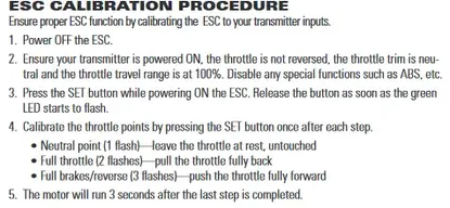

Yeah I have read it and tried it 20 different times. When it beeps three times I give it full reverse. Then save it after step 5, reset it and still no reverse. Not sure what I am doing wrong. I’ve looked for videos for programming this ESC specifically and came up with nothing.
I actually had this problem yesterday. When powering it on hold down the settings button and release when the green light starts to flash.
A la...
Hmm... When I did it the motor didn't spin up for 3 seconds so I just powered it off and then back on again and I had reverse again. Try holding down the set button before turning on the power.
So hold the set button when I’m turning on power? I was thinking of deleting it completely and starting from scratch. Idk what else it would be lol
