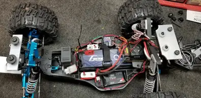

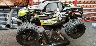

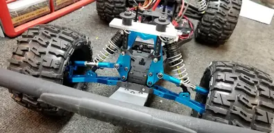

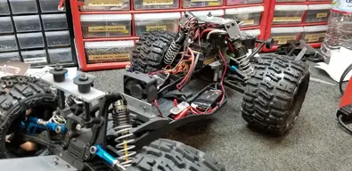

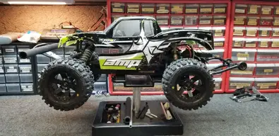

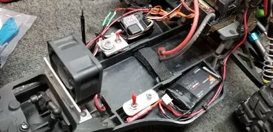

Max, don't be disappointed, the AMP is a great truck to start out with and easy to work on. Hayitsme suggestion is the way to go, sounds to me the motor went bad. I myself have an AMP, it was my first RC and to this day one of my favorites (However it's all molded out) which you guys can do also. It's a great truck to do upgrades on. With it being stock right now I would keep out of the grass, those stock brushed motors don't do to well in the grass, I went through 3 motors running in the grass, until I upgraded to brushless. It is habit forming as I have 28 RC now.
