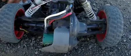

friends AMP
He didn't trim them down enough they look funny but don't bind idk y....
