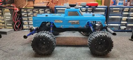

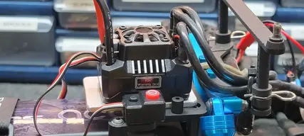

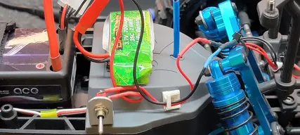

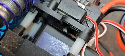

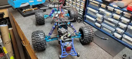

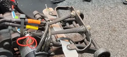

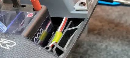

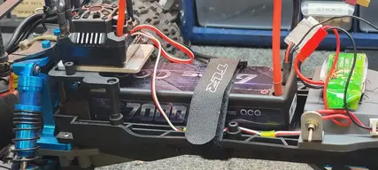

ecButler, I have two AMP Crushes, Orange and Blue. I will say this, it's a great truck when it's upgraded. I run a Gen Ace 11.7-volt 7mAh (7 amps) 3S battery on it and, a 3.7- volt .700 mAh battery for the LED lights, as we run at night also. the lights are controlled by micro toggle switches. As you can see, I had to raise the ESC platform in order for the 3S battery to slide under it. If you go with a 2S LiPo, this won't be a concern. Also, if you notice, I mounted an aluminum plate onto the ESC platform with M3 flathead screws. This helps to dissipate some of the heat away from the ESC and keep things cool. I did away with the stock battery tie down and went with a battery strap. That won't be a concern with a 2S LiPo. You can mount your receiver under the Servo cover and use a piece of fuel line hose, sliced, over the wires and tucked into the hollows of the chassis. Makes for a good clean wire installation. As you can see the body has been modded out also to save it from tears and rips, we do a lot of running on asphalt. The back LEDs are mounted on a Traxxas nerf bar, which is mounted on a 1/16x3/4 piece of aluminum across the wheelie bar frame.
I don't know what motor you are going to go with, but I would go with Hobby King or Castle combos if your pocketbook allows you to do so. Both are great combos. I would also go with a new radio and receiver if you can. All this depends on how far you want to go into the hobby. If you and your son are just getting started, I would keep the speed down until he, or you, can control the truck without hitting curbs, car tires, trees, etc. There is a learning curve and it's just part of the hobby. When I first started, I was breaking parts left and right. But practice makes perfect and it all falls in line. A lot of mods I make myself which is what the hobby is all about. Hope this info helps you make your decision, and hope you and your son enjoy the hobby, it is addictive, I have 36.
Happy RCing!

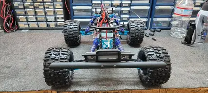

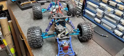

Thanks @weave, I also have been thinking of raising my ESC shelf just so I can accommodate my 3s hard case pack. I actually thought of doing that, now that I have seen it done, I may giver a go. I assume your RX lives under the front cover next to the steering servo? Or is it in plain sight in your posted pictures?

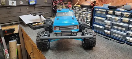

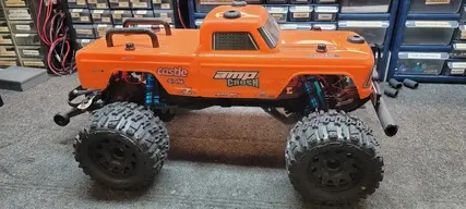

You can mount the receiver on top of the servo cover if you want, it would definitely be easier to get to. So here's my Blue Amp Crush with Hot Racing and Pro-Line wide traction set-up. It's pretty hard to flip the truck now from stock, and, it corners like you wouldn't believe. The bumpers you see on top of the body are to protect the body when and if it flips, as we do a lot of asphalt Racing. They’re furniture bumpers for legs on chairs and sofas.
I'm a retired journeyman machinist, so this is what I do, tear down and make better. If it doesn't work, back to the drawing board. Some parts I made myself, if I can't buy them. Anyway, that's what the hobby is all about, it's kinda like owning a race car, you're always trying to make it faster and handle better.

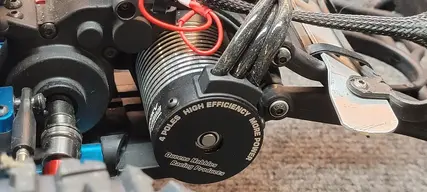

So just took this baby out and ran it hard on the asphalt for about 20 minutes with the motor fan on. Temp on the motor was 112 degrees after I finished. Going to try without the motor fan on.
Motor temp without the motor fan on is 156 degrees.

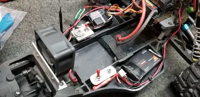

That is pretty hot @weave . Quite a difference with and without a fan. Any idea what the acceptable temp range is for a brushless motor? I realize that may be a pretty broad stroke, maybe just generalizations?
WithinU, you want to try and keep your brushless motors below 170 degrees, 150 would be great, or lower (with a high-velocity fan) over the motor. Most of the small RC fans at the hobby stores are not high-velocity fans, meaning they don't push a lot of air (CFM).

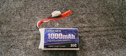

Below is what I use to cool my brushless motors. This fan is about 7.5 CFM and is .60 amp at 5 volts. You can run this fan on a separate 7.4 LiPo drone battery and it will run a long time before you have to charge the battery. I wired mine in a switched (micro toggle switch) array, so on cool days, and nights I don't have to use the fan, or you can run it in intervals, it's your choice. You will have to solder the same type of connector on the fan that matches the battery to make the connection (male to a female). As you can see in the picture with the micro switches, I also use the same type of fan to blow air over the chassis when the body is attached. I know it sounds like a lot of work, but it's worth it. If you have a used electronics store in your area, you should be able to find these fans. Just remember don't go below .45 amps. You can also check eBay. Hope this helps in your RC adventures.

WithinU, I made an error on the voltage of the fans. They are 5 volts, not 12 and, can be run on a 7.4-volt drone battery. 850 mAh or 1000 mAh. Sorry for the typo, it has been corrected.
