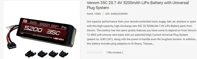

Yeah I got a 2S, 35C, 5200mah battery too.. I'm already used to the speed and I went up 6 teeth on my pinion and the car is just not fast enough for what I'm looking for. So with the dyns1450 you guys have gone through your manual if we were bench racing with cars setup special to not overheat what's going to give me the best bang for my buck. Has anyone ran 3s? I missed a chance to try one and I would have loved to see a 15mph bump up from the previous 31mph.

Sorry if that was confusing, I was running the tazer twin combo. 3000kv with the electron 2s 35c 5200mah 24t pinion is the largest I could fit into the car with 87 tooth spur.
